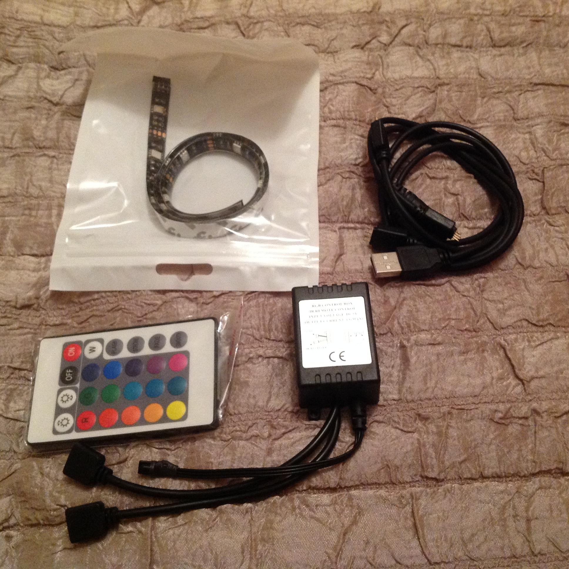

      This is the kit,  there is two strips of led’s and two outputs from the small box  I remove one of the output cables, fit the box where the credit unit used to be & fix the remote sensor to the r/h speaker if situated correctly the sensor picks up the signal from the remote.  One strip is plenty for an SC the strip is self adhesive and can be fitted in the cream coloured plastic plastic lid , you do have to cut a small slot in the plastic, I remove the old bulb holders and associated wiring & give the plastic a good clean . Bought them off a well known auction website think the kits were about £8
      Cheers Scudie
